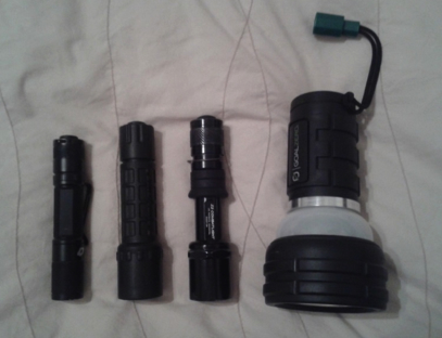

Meet the Lights
The lights I’ll be using for this article are:
1. 4Sevens QT2L
2. Surefire G2 (stock)
3. Surefire Z2 Centurion with Malkoff M61L Lamp
4. GoalZero Chubby
For the purpose of the article, it’s important to mention that all my lights have been upgraded using Oveready.com’s 17670 batteries, which offer a dramatically improved battery life over standard CR123 batteries and, perhaps most importantly, are fully rechargeable. I recharge these batteries from alternate, sustainable energy and am comforted by the knowledge that in an emergency, I’ll be able to recharge my lights, rather than be forced to find, stock, or trade for batteries.

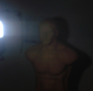

40 Lumens, Ambient, 1 meter distance:
This is with a ‘lantern flashlight’, a GoalZero Chubby, which produces 40 lumens of lighting. In this picture, the lantern is 3’ from the target. You can see that the light is not producing a directional corona. This light is entirely ‘splash’ lighting – that is to say, it’s not ‘directional’ – and it radiates ‘evenly’ outward from the light source.

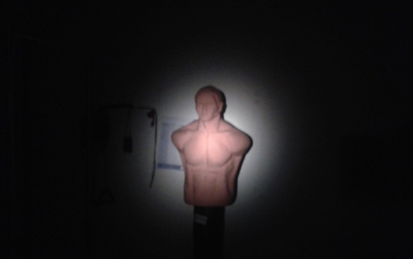

60 Lumens, Directional, 1 meter distance:
This picture depicts a 60 lumen Surefire Z2 from the same distance, 3 feet. You can see that there is a corona around the “thrown” light that covers the head and neck, and then “splashed” light on the wall behind the target. At this distance, the light is bright enough that it is difficult to make out the face of the target – on the receiving end, it is overwhelming.
However, by increasing the distance, we will see different results. It’s important to note that at this distance, your chances of an altercation are high, and being able to focus a light and its effective use will be dramatically diminished.

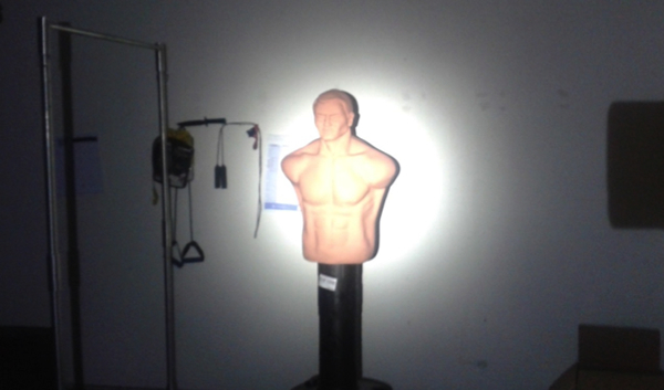

60 Lumens, Directional, 3 meters:
Here we see the same light (Surefire Z2) from a range of 3 meters, or 9 feet. The “splash” characteristics have almost entirely gone, and we see that this light is very directional. At 60 lumens, it doesn’t radiate outward far enough to cause much, if any, illumination on the periphery of the beam.
To illustrate the splash effect, try to identify the things you ‘see’ in the background. Keep them in mind, and let’s press on.

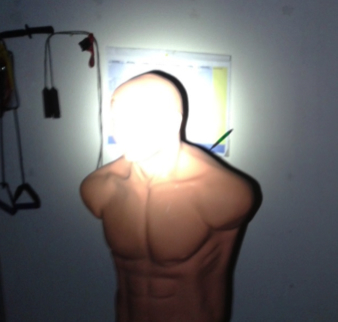

240 Lumens, Splash/Throw lamp, 1 meter distance:
This picture was taken is using 4Sevens QuarkQT2L flashlight.
As you can see here, the background is bathed in light – this is a much higher intensity lamp that is designed to have throw (again, note the corona) and splash. You can start to make out objects in the background a little more clearly
The light is still washing out the target’s face, and this is a very punishing light if you are on the receiving end, but again, it’s important to avoid getting this close to someone you suspect may be up to no good.
