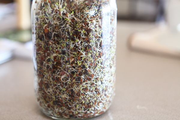

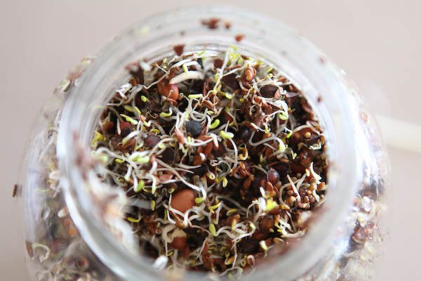

“I have had success sprouting other seeds, too.”
Sprouting seeds definitely does not have to be limited to barley.  Other seeds can be mixed with the barley and can be grown together directly in the trays.  Or try sprouting using traditional sprouting jars, buckets, or tubs.  We have successfully sprouted a large variety of other seeds.  This list includes sunflower seeds, Austrian peas, wheat, buckwheat, oats, ryegrass, millet, alfalfa, and a variety of clovers.  See what is available to you locally, experiment, and find what works well for you.   A diversity of sprouts enhances the nutritional value of your animal feed even more.

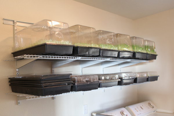

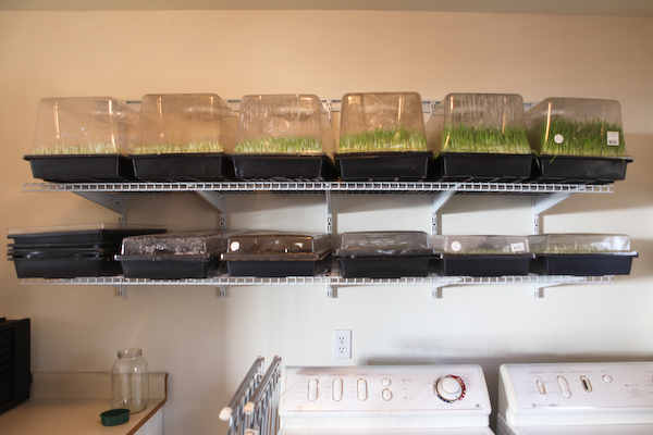

“We want to expand our production, but we are limited on space.”
Almost immediately after writing the initial article, we installed a shelf in our laundry room that allowed us to expand our system.  We now soak enough seeds for two trays at one time.  After the initial pre-soak, we split the contents of one tub into two.  With just a little bit more time involved, we have doubled our production. We can now harvest two trays of fodder every day, thereby reducing our feed costs even more.
