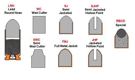

Types of Bullets
Bullets come in various types that are denoted as suffixed acronyms; these bullet types can be visualized here:
There are several other types:
SP – Soft Point – the tip of the bullet is left uncoated (exposed lead)
AP – Armor Piercing – this ammunition has a alloy core, instead of lead
BT – Boat Tail – this means that the rear end of the cartridge is tapered to stabilize the projectile in flight
BTHP – Boat Tail Hollow Point is a combination of the Boat Tail and Hollow Point Features
