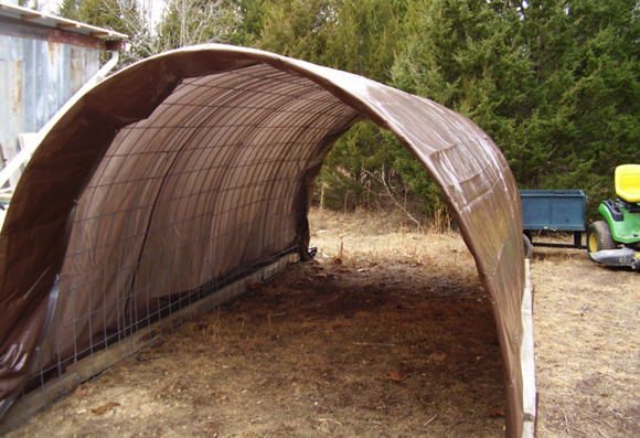

Weather / Storage Shelters
With some t-posts, medium gauge wire and the right sized tarps, one can setup a low cost shelter for animals, hay, tools, and more.  One of the nicest aspects of this type of shelter is that is goes up very quickly and does not require any building permits to install.  This flexible design can easily be made longer by adding additional panels and tarps.  The final cost will of course depend on the length needed and the quality of the tarps.
Source: http://slatehill.blogspot.com/2011/01/cattle-panel-shelters.html
Some Considerations:
  • Keep in mind snow load and wind conditions in your area when setting up a structure and securing it to the ground or a base.
  • As mentioned above, there can be sharp edges on the ends where the panels are cut to length and you need to be mindful of these when attaching a tarp or covering to keep from poking holes through your covering material.
  • Covering selection is important as transparent materials can cause a greenhouse effect thereby making the shelter uncomfortable to work in.

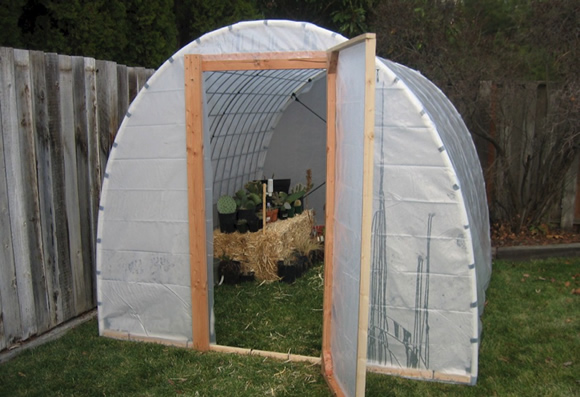

Greenhouse
Along similar lines as the shelters mentioned above, is the potential of using livestock panels for a greenhouse.  With the addition of a framed based, some framing for a door, and some greenhouse plastic, livestock panels can easily be used for a hoop house  or greenhouse type structure.
With a simple back of a napkin calculation, one can find that a 8x20 foot greenhouse can be constructed for less than $200.  This is a very affordable option to get spring starts going or to extend your growing through the fall and winter.
A greenhouse structure of this type could also make a great enclosure for a aquaponic system where climate control would be favorable.
Source: http://www.fyall.net/greenhouse-14thegang.jpg
  • Ventillation - humidity and airflow are vitally important to a healthy environment - it can get hot fast in closed up greenhouse.
  • Snowload - support beams may be necessary in heavy snow load areas.
  • Benches and Thermal Mass - Water barrels with wooden slate benches need both of these needs
  • Wind / Anchors - make sure your neighbor does not get a new greenhouse in their yard on the next windy day.
  • Plastic Selection - Try to get a plastic covering that has a 3-4 year rating.

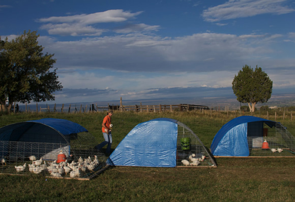

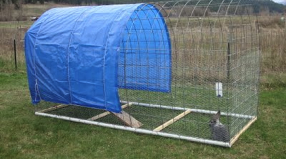

Chicken / Rabbit Tractor
Like the permanent structures used for hay and tools, and with the addition of a framed based, livestock panels can be used to build portable chicken and rabbit tractors.  If you have the space to provide this mobile option to your chickens or rabbits, a rotational grazing method helps keep animals on new grass every day and also protects them from predators and the weather.
Source: http://kinikinfoods.com/
Source: http://little-avalon.blogspot.com/2011/04/rabbit-tractor-version-2-is-finished.html
  • Wind: if you are in an area where high winds are a problem, consider adding a method to secure your chicken tractor to the ground.  An open tarp can be a powerful wind catch and you don’t want your structure blowing over and killing birds.
  • Access.  If adding doors and other items, weight and portability can become an issue.  Wheels / skids may be necessary.
Here is a great How to Tutorial on chicken tractors:  http://www.backyardchickens.com/a/cattle-panel-hoop-coop

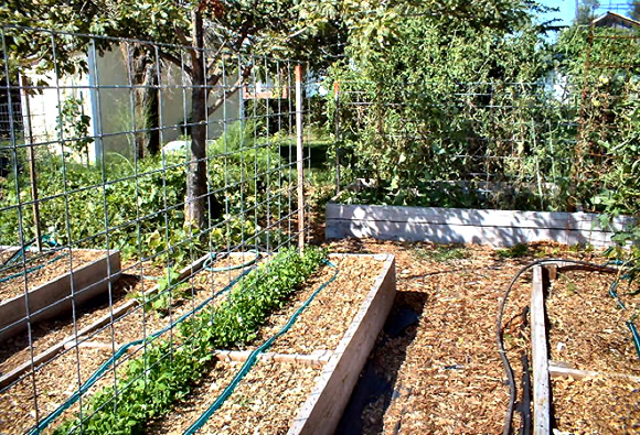

Arbor / Trellis Styles
If you need a sturdy and supportive structure to trellis plants or create an arbor that leads into or incorporates into your garden, livestock panels can handle the job.
They can give a beautiful and supportive arch that will allow plants to grow up on and create covered entryways and simple to setup short trellis segments of crops like pole beans and cucumbers.
Source: http://www.flickriver.com/photos/windley/3564709484/
Source: http://www.thinds.com/jmh/literary/a_vegetable_garden_for_everyone.htm
Source:  http://natursgarden.files.wordpress.com/2010/09/backyard-beds-2.jpg
  • If the panels will need to be cut down to size, this may require a good hacksaw or heavy-duty bolt cutter.
  • Keep in mind the space and support requirements for trellised plants and their weight.
  • Be mindful of where the trellises are placed as they could reduce the sun exposure of other plants that need the light.  A general rule of thumb is to keep high growing trellised plants on the north side of the garden, to maximize the sun in the south (at least for us in the northern hemisphere).

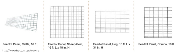

important to know specs of panels
What I didn't realize at first is that different brands of panels are created of different gauges of wire.  The Tractor Supply panels are much thinner wire than the ones from my local feed store.  Now I actually like the thinner gauge panels because I use them as temporary gates across a 16' perimeter pasture corridor (yes, I made it that dimension for this reason) and I have to muscle them around a lot.  However if you want panels for something needing greater strength I'd suggest paying the extra money and getting them from a different source.  I wouldn't have known this without having panels from different sources side-by-side and noticing the huge difference.  The heavier ones do not bend as well as the other ones and so may not fit into a pickup that way.  I've put them longwise in the bed and over the cap with padding on the cab but it sure is hard to unload without scratching a little paint somewhere!  I've used them for gates, lambing pens, tree protectors in pasture corners, and trellises.   To protect a tree in the corner of a pasture I put 2 eye bolts into the fence posts that brace the corner fence post.  I put one end of the panel against the post and slide a piece of rebar down through the 2 eye bolts to secure the panel. Then I bend the panel so it gets to the other side bracing fence post and repeat the process there.
Look carefully at this blog entry and you can see this system.  http://foxmountainfarm.blogspot.com/2011/10/our-pasture-system-is-not-regular.html
You can also see a panel manger made here.  This was bent using 2X4s and body strength.  Other posts show other uses for the panel in the barn.
