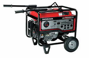

Traditional Generator Solutions
As a safeguard to these extreme weather events, many people have purchased and used a gasoline, diesel, or propane (liquid fuel) portable or fixed generator to deal with events and blackouts.
There have been many choices and refinements in generator design, and costs have tended to stay down on the lower end products because of Asian imports. Also, gas fuel prices have remained relatively low, compared to overseas and non-subsidized costs per gallon.
When the power goes out or you need some off-grid power, the easy and entry level choice has been to grab a generator, throw it in your truck or RV with some fuel cans, and fire it up when you need to run your electric applications. You can get 5 to 7 Kw generators that are still relatively portable, and, when bigger than that is needed, you can put them on a trailer for portability. However, because fuel costs have been low, there has not been much consideration for efficiency or long-term costs to running a gas powered generator for extended periods of time.
When gas prices shot up to nearly $5 per gallon in 2008, people started to feel a little pain with this approach, as you only have power when the generator is running, and all generators have some “gallon per hour” consumption figure based on a full or 50% load, which needs to be taken into consideration. Generally, that means you need to keep pouring in the fuel. If you need to run electricity 24/7, that really starts adding up. Plus you have to ensure you have enough fuel to last you through the duration of your emergency or situation. That can sometimes be a lot of fuel. You also have to figure in the oil changes and scheduled maintenance by hours run, as well as having to listen to it and smell the fumes coming out all the time.
