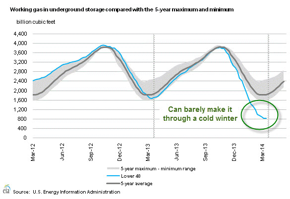

And even with the shale plays, in April 2014 the US remains a net gas importer. In 2013, the most recent full year of data, the US had to import 1.3 trillion cubic feet to satisfy domestic consumption.
More pointedly, 2013 was a pretty cold winter, the kind that comes along every so often, and the US barely made it through that period without running dangerously low on NG as it was.
To make it through the heavy demands of winter natural gas must be stockpiled in advance. As a result, the gas storage report always shows seasonal builds and draw downs of natural gas:
In all my years of watching the energy statistics I've never seen NG storage get this low. Look how far below the average 5 year range it got...all the way down to just 800 billion cubic feet in storage.
And this was with the "shale gas miracle" chugging along merrily in the background.
