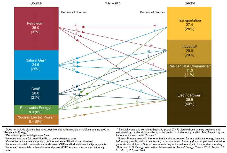

Where does the energy come from?
The majority of our electricity is generated by coal, followed by nuclear, with natural gas not too far behind. Natural gas is our major source of home heating, followed by petroleum:
Primary Energy Consumption by Source and Sector, 2010  (Quadrillion Btu)
source: U.S. Energy Information Administration / Annual Energy Review 2010
