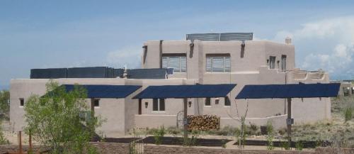

I thought I would share a picture. Just a little over 1 year ago I discovered the crash course. I attended the Lowesville seminar and decided I needed to take action.  I have now installed on our home:
  • 13 Thermal solar panels providing domestic hot water and heat
  • 10.8 kW AC coupled battery backup solar array.
I wanted to show this because it shows you can take fairly significant action and implement  it in a fairly short period of time.  However, if you are going to take action, you need to be aware that from start to finish these projects took almost 10 months.  That is time to learn, get quotes, bargin, construction, and commisioning of a system.  It definitely takes far longer than I thought to get it all done.  I'm also just excited that it's finally very very close to complete. Laughing
Solar on house
I have had a fair number of questions from neighbors about the systems.   I have already handed out Crash Course DVD's to the neighbors but I now plan on having a  party and getting the neighbors together to show off the system.  I figure if you lead by example it might help to get people prepared.  I think it also encourages people to watch the Crash Course, since I reference it whenever anyone asks why I did all this (they are trying to determine if I'm insane).  I have also found that even if the people won't watch the crash course, with PV and current incentives, most people show interest when you explain how you can get a 10% ROI (YMMV) and that may at least help them be a little prepared when/if TSHTF.

rhare - Bravo!
That's quite a system you've installed there.  I congratulate you on leading by example, it's really the best way of them all.
I also want to second your observation that getting things done just takes time.  More than some might imagine.

Awesome system, thanks for sharing.  I agree with EGP - each of us has to do what works for us, the days of a one-shot solution are over (if they ever really existed).  In our case, we have more than enough sun for solar thermal and PV in the summer, and we heat the house and water with the woodstove in the winter when there is no sun (well, only a couple hours of weak sun). We're planning to make our own ethanol since diesel gels at our winter temps and oil-bearing crops don't really like it up here, and it's too cold for a methane digester most of the year.  But, if we lived somewhere else, we'd be building an entirely different system :)
I think a lot of people get hung up on ERoEI and ROI, and that data can be a bit skewed because it isn't always comparing apples to apples and doesn't always include all the hidden costs. Sure, your grid electricity may only cost XX per kWH, making it appear that RE has a low ERoEI and it takes forever to recover your investment, but that's only if you don't take into account all the other hidden costs (like taxes that support the infrastructure) and Embodies Energy in conventional systems. But anyway, in the end, the biggest ROI of going with a RE system is that you are in control of your own power... there is no price tag on peace of mind!

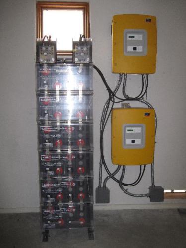

SMA doesn't sell the Sunny Backup in the US so we used Sunny Islands (look the same) for the battery backup with Sunny Boys for the grid tied inverters. I think the Sunny Backup just simplifies the wiring.
For batteries, in Austrailia/NZ you might check out  Redflow.  They make a Zinc Bromine flow batteries. They also were not selling  in the US and I think may still be beta testing if you want to be a test subject. :-)   Wikipedia and their web site says "They have no shelf life".   This may mean they can sit a float and not degrade.  We went with the VRLA AGM batteries that are built for telcos (see previous post) because I'm of the mindset that things will get expensive and may be chaotic, but I believe we will have grid power most of the time.  If I'm wrong, then our batteries will become toast much sooner than the 20 year life expectancy and it would have been cheaper to use regular lead acids, but by the time that happens if I had used regular lead acids I would have had to replace them anyway.  So I think in the ends it's probably only a cost issue.
Here is a picture of the AC coupled battery backup (note the batteries are not leaning - just look that way in the picture):
