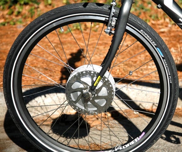

Common brands of internally-geared hub motors are eZee, Brushless Motor Corporation (BMC), 8Fun (Shouzhou Bafang), and Heinzemann. The eZee is a very reliable hub motor for moderate-power use, and the 8Fun is a smaller, lighter motor for light-duty use. BMC makes a range of motors at different power levels, and they are the only company that makes a high-power, internally geared hub motor. The BMC motors are nice in their versatility, but the reliability does not yet match that of the eZee.
eZee hub motor kit incorporated in the front wheel

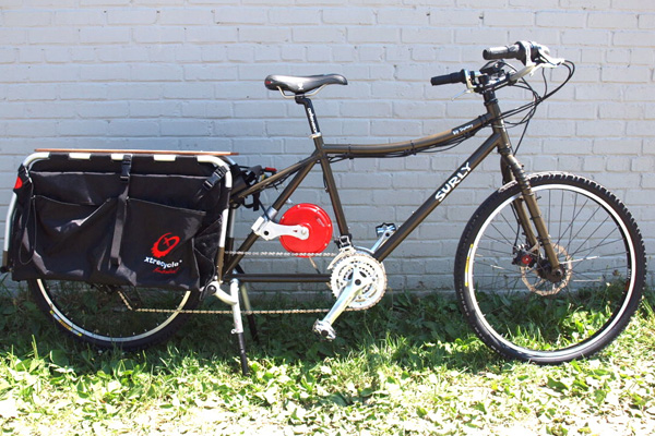

Picture of the StokeMonkey electric pedal assist installed on a Surly Big Dummy
Advantages: This style of motor i can use your bike’s gearing, which is a big win for steep hills or heavily loaded cargo bikes. They are often more efficient at converting electric to mechanical power as well.
Disadvantages: Some of these styles are noisy (e.g. the Cyclone), and others make the rider feel like they are being pedaled. With a hub motor it is possible to just stop pedaling and let the motor do the work, but with some of the drive-train motors, you must always pedal. Also, these styles tend to be a bit more difficult to install than the hub motors, especially for those styles that require an interface to the crankset or bottom bracket.
One of the best-known drive-train style systems, designed specifically for electric cargo bikes, is the Stokemonkey. This motor acts like a “stoker,” which is the second rider of a tandem bike. In fact, it uses a crankset designed for a tandem bicycle. It is a quiet and high efficiency setup for those with cargo bikes who don’t mind the idea of always pedaling when in operation. A second common brand is the Cyclone, which mounts underneath the bottom of the bike (the bottom bracket) and interfaces directly to the crankset (where the pedals are attached). Though I don’t have personal experience with it, users seem happy with it, with the exception of two issues: IIt can be noisy, and the installation can be difficult and time consuming. The third one is the EcoSpeed, designed as a mid-drive system for recumbent bikes.

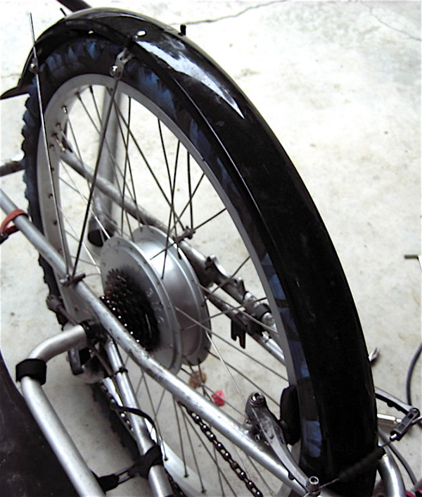

Front or rear
For hub motors, a matter of consideration is whether to use a front or rear hub motor on the bike. They each have their merits. A front motor tends to balance the weight on the bike a bit better, and it also gives a kind of all-wheel drive to the bike (the rear wheel being driven by the pedals), which is good in slippery or wet conditions. The problem with a front wheel hub motor is that it puts extra stress on the bike fork, which is the part of the bike where the front wheel attaches that turns when you turn the handlebars. In our experience, it is a bad idea to combine a powerful front hub motor with any kind of aluminum suspension fork (most are aluminum), because the fork can break. I recently heard a story related to this: A guy buys a folding bike with an aluminum suspension fork and puts a large, powerful hub motor on the front of it. His first fork broke, but, not to be deterred, he convinced the manufacturer to give him another bike under warranty. He broke that one too, complete with a trip to the hospital. Not good for anyone.
That said, steel bike forks are much more resilient than aluminum and should be able to handle low to moderate power hub motors. You can tell whether your fork is steel by holding a magnet up close to it - if the magnet sticks, it is steel; if not, it is something else.
Rear motors are popular because they avoid this issue altogether, but they come with their own challenges. Most rear hub motors can only handle 7 to 8 gears, so they won’t work directly with 9- or 10-speed shifting systems. They are more difficult to install, because you have to mess around with the drive-train. And they put all the weight at the back of the bike, which already has most of the rider weight on it. My own rule of thumb is to recommend a front motor for those who have a steel fork (or are willing to put one on) and who don’t want a super-high power motor, and to go for a rear motor otherwise.

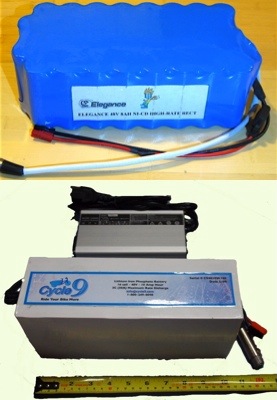

There is a dizzying array of battery types available, and which one you choose will significantly affect the cost and weight of your electric bike system. The lighter options are generally higher-cost and the heavier options are lower-cost. For many years, e-bikes used sealed lead acid (SLA) batteries. A typical 36-volt set might cost $120-180 and weigh well over 30 pounds. The advantage is low cost; the disadvantage is weight and that it contains lead, which must be recycled properly. At the mid-range are nickel cadmium (NiCa) and nickel metal hydride (NiMH). For a 36-volt setup, these may run $250-$400 and weigh just over half of what a lead acid pack weighs, or around 15-18 pounds. Nickel cadmium is usually a bit less expensive and a bit heavier than NiMH, and it poses an environmental concern if not recycled properly.
Picture of NiCd battery pack (top) and Lithium Iron Phosphate pack (bottom)
At the high end of the battery range are lithium ion (Li-ion) batteries, which, for a 36-volt system, can range from $400-700 and weigh as little as 7-8 pounds. The advantage of these is the light weight and small form factor; the disadvantage is the high cost.
To make things more confusing, there are various kinds of lithium battery technologies, each of which fall under the term “lithium ion” but use a variety of different chemistries, in addition to the lithium, that give different properties. Lithium cobalt oxide (LiCoO2) batteries are super lightweight but also unstable and unsafe for bike use (think of laptop or cell-phone batteries that catch on fire - those are nearly all LiCoO2). Lithium manganese (LiMn) is considerably safer but also heavier than cobalt oxide batteries, though still substantially lighter than the nickel or lead acid batteries. This is a good lower-priced option for those wanting the light weight of lithium on an electric bike. Lithium iron phosphate (LiFePO4) is the latest lithium technology` and is both highly stable (hence safest) and long lasting (if properly cared for, as many as 1500 or more charge/discharge cycles can be achieved). LiFePO4 comes in a variety of formats that range from extremely lightweight prismatic/polymer style cells to heavier duty cylindrical cells meant for larger electric vehicle use. The main downside of LiFePO4 is its cost - it is the priciest of all battery options.
Battery pack construction is a critical consideration in buying an expensive lithium or nickel battery. To achieve voltages like 36V, battery packs use a set of individual cells strung together in series, each one contributing a bit of the voltage. With lead acid batteries, it usually only requires three individual 120-volt batteries to get a 36V pack. But for nickel chemistries, a typical 36-volt pack may use as many as 30 individual cells. And for lithium chemistries, a 36-volt pack is composed of 10-12 individual cells (depending on type). For the nickel batteries, and especially for the more finicky lithium types, it is important that the manufacturer of these strings of cells knows what they are doing. We’ve seen many inexpensive packs fail because they weren’t assembled properly and used battery-management systems (the brains that keep all the cells healthy) that are sub-par. If you don’t mind tinkering with electrical stuff, an inexpensive pack can save some money, but may require an investment of time. For those without interest in that, I strongly recommend spending a bit more money for a well-built pack from a reputable seller.

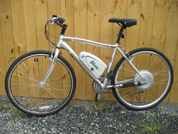

BionX battery mounting in the center triangle of the bike.

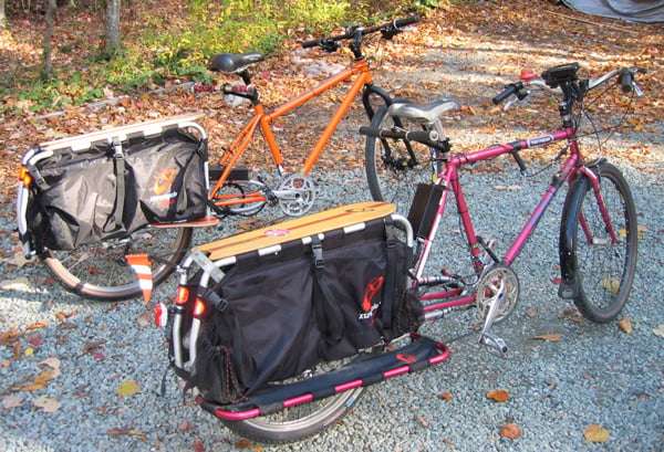

The Xtracycle was the inspiration for a new movement in cargo/utility bicycles that go by the name of “longtail bike.” The longtail bike is simply a bike with an extended wheelbase to enhance its cargo- and passenger-carrying capacity. Longtail bikes are typically narrow enough to negotiate trails, sidewalks, or narrow roadways, and they tend to be more efficient than cargo trikes. They handle almost like a regular bike, except for very tight turns. In fact, in some instances their climbing ability is enhanced, due to their longer wheelbase.
Rider and child on longtail bike consisting of a steel mountain bike frame that has been extended using an Xtracycle Freeradical kit.

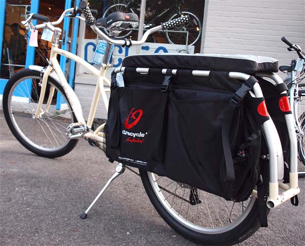

Xtracycle
Xtracycle is still the biggest name in the longtail market, with their flagship product, the Xtracycle Freeradical conversion kit. This is a conversion kit that converts a regular mountain/hybrid/touring bike into a longtail bike by extending the wheelbase. It can handle up to 200 lbs of cargo, though you may want to upgrade your rear wheel to a heavier-duty one if you are going to regularly carry that much, as most standard rear wheels aren’t designed for that much weight. However, for light loads (< 70 lbs) you can often get away with just using the standard wheel, after a check for proper spoke tension.
The Xtracycle uses a modular plug-and-play system for accessories, like a “long loader” to carry long loads like ladders/kayaks/sailboards, a “wide loader” to carry loads like television sets, computers, kegs, sofas, and footsies to carry passengers.

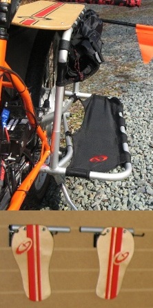

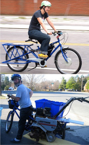

Footsies
Advantages: This is the least expensive way to get a longtail utility bike, because you can often find a decent older mountain bike for around $50, and then get the conversion kit for $489. It is a modular system with a growing array of accessories. It adds only 6-10 pounds to the bike (depending on options). When unloaded, your bike will handle mostly like it did before conversion.
Disadvantages: First, when it is heavily loaded, the rider will often notice some flex, since the bike is essentially two pieces. The key to minimizing the flex is to make sure loads are carried tightly and as close to the rear wheel as possible. On some bikes installation is complicated due to unusual designs. Also, the installation of the kit can change the steering a bit, sometimes making it a bit more sensitive. The extra weight bothers some people. The bike may not fit up narrow stairways, in small elevators, or on some bus racks.
Regardless of these disadvantages, after trying one for a while, many people (myself included) cannot imagine going back to a regular bike for things like shopping, running kids around, etc.

Yuba Mundo
Ben Sazarrin was involved in the Xtracycle project early on, but wanted to take the longtail concept in a different direction by providing a more inexpensive and heavy-duty longtail bike that would satisfy the needs of developing and developed countries alike. The result of his efforts is the Yuba Mundo, a longtail bike made of a solid steel frame with super-beefy rear wheel, capable of carrying up to 400 lbs of cargo. The complete bike retails for $899 and comes standard with a 6-speed system, comfort/cruiser style handlebars, and a fairly relaxed riding position.
Advantages: The price is right. The Yuba comes with wide-loader platforms built in, so big loads can be carried with a low center of gravity. It can haul huge cargo weight. The Yuba is made of weldable steel. There is a huge pannier available for it. This is a one-size-fits-all bike, and it seems best set up to accommodate people 5’5-6’3 or so. The Yuba rides the most like a regular bike when unloaded. It is the most solid and well-handling of the longtail bikes we’ve tried when heavily loaded.
Disadvantages: The Yuba doesn’t work with the plug-and-play Xtracycle system. The 2008 models are limited to six speeds, though there is now a retrofit kit to convert to 18 speeds (and the 2009 model has 18 speeds). It weighs a lot - the 2008 models weighed around 70 lbs unloaded. The 2009 models promise to be a bit lighter. The components are only mid-grade.
Erika riding the Mundo (top). Dave carrying his Roto-tiller on the wide loader of the Yuba Mundo (bottom).

Our first generation electric utility bikes. On the right, a ’93 Specialized Stump Jumper with an Xtracycle extension, and a modified Currie USPD electric kit. Initially it used 24 volt lead acid batteries, then was upgraded to NiMh and finally LiFePO4 batteries.
Our first electric utility bikes. On the right, a ’93 Specialized Stump Jumper with an Xtracycle extension, and a modified Currie USPD electric kit. Initially it used 24 volt lead acid batteries, then was upgraded to NiMh and finally LiFePO4 batteries.
Another option for those with kids to haul would be the Madsen cargo bike with an eZee electric assist kit. When the Madsen is loaded up with kids, it can be quite challenging to pull uphill. The eZee is an internally-geared hub motor with a fair bit of torque for hill climbing, and the kit comes with a lithium manganese battery to keep the weight down. We have a Madsen/eZee combination that we use frequently for kid-hauling, and it works well.
